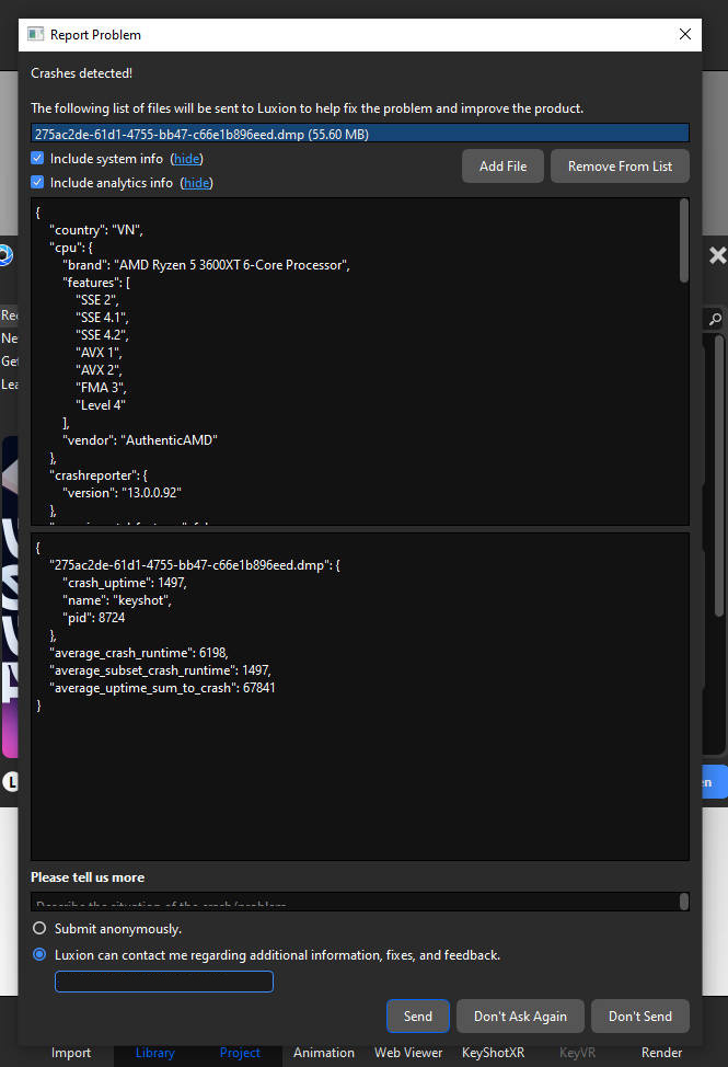

I help a problem with keyshot rendering crash. My project need render about 100k shot of web configuration. But it always crash when rended 1k. Please help me

I wonder if it can be some kind of limit if it crashes exactly at 1K images. You might want to send the scene and ticket to support to hear if that can be the issue.
While not ideal, maybe you can render 10 batches of 1000 shots and put the images together afterwards? You might need to do some batch rename action on the images but might be a workaround. I’ve very little experience with rendering for web but if you want you may send me your scene with a private message posting it as KSP on wetransfer.com for example and I can check if I can get further than 1K shots.

No it’s not a limit issue. I tried with a smaller number (768 img) but it still fails. I have created a ticket and am waiting for support. Thank you.
